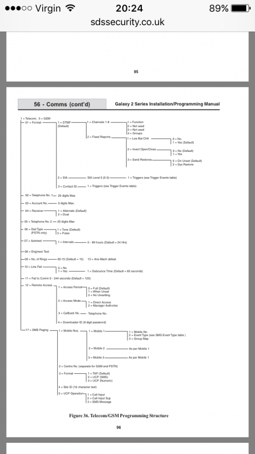

Thanks Neil. How do I get to option 56 from the menu ?
Do I just enter 56 instead of 13 to get into that menu?
Try engineer code then enter then engineer code then enter then 56 then 10 then 1 to disable
Thanks I'll give that a go tomorrow. Does this switch off all coms or are there other settings in need to turn off as well?
If that dosnt work user code + ent+48+Ent+1+Ent+esc+esc then engineer code +ent
Then 56 then 10 then 1

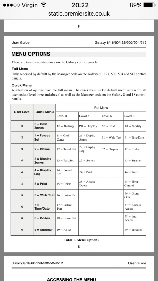

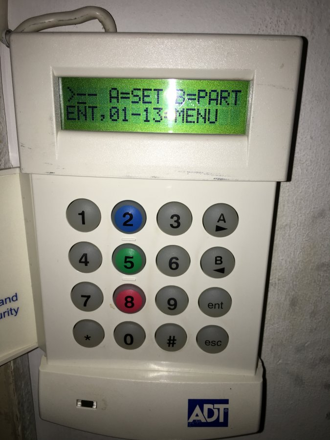

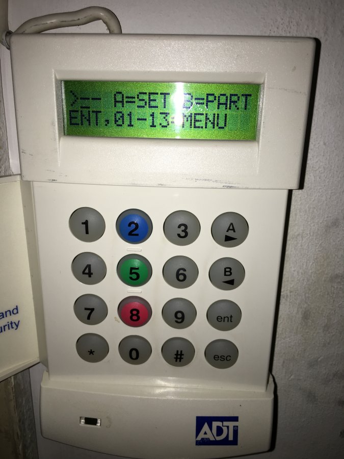

It won't let me enter 56 as an option? Only allows 1 to 13 ?
Are you in def in eng mode cause mine displays eng mode in banner
Mine usually displays enginee mode at too but does not now since it's displayed telecom failure?
The first pic is for Galaxy 8 and second for Galaxy g2
The 8 plus is a completely different menu structure to the proper Galaxy panels. Best bet would be to delete any account and telephone numbers in menu 12 to stop the alarm trying to dial out, then disable the line monitoring in menu 13 to stop it looking for line volts.
