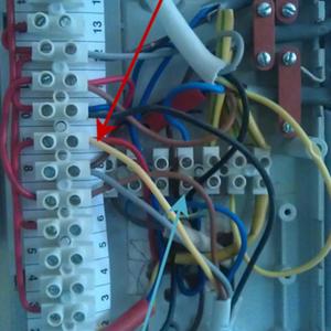

    Replacing analogue with digital room thermostat
    Following the yellow cable from 2 back to its source, the red from the same source goes to 9 on the long vertical block connector, marked by my red arrow on the picture below. The blue goes to the smaller, horizontal block connector, out the other side of which is a further blue wire that heads...
    Its a glow worm Ultracom 30hxi boiler. I can't directly trace the wires, they disappear into a concrete wall in the hall, I assume head vertically up to cross and come back down into the utility room where the boiler sits. Taking the cover off the power unit to the boiler I can't determine if...

  6. C
    Instead of buying (and blowing the fuse on) a meter I have used a 60W bulb; neither combination of red and blue, or yellow and blue wires light the lamp. How the existing thermostat works is a new mystery. I will seek professional help, thanks to all of you who have responded.
  7. C
    Old stat is back and working. Have just wired new one into a plug and it works (hooray & phew), see photos: Would it be worth me buying a meter to see what is happening at the red and blue wires coming out of the wall? Really appreciate your continued advice.

  10. C
    Hi, I'm not using an underfloor sensor (yet) and at the moment there is no display or life to the unit at all, so I'm not able to reconfigure the advanced parameters. I hope I haven't blown it up by wiring it up wrong the first time - is there a way I can check? I can't confirm the wiring is...
  11. C
    Many thanks for the Hint, I had seen that post but still not bright enough to figure this out I'm afraid. I have now got Yellow to Load, Blue to Neutral and Red to live but the unit will not power up :( It might be time for me to pay a professional.
  12. C
    Hi I know this question has been asked before on this forum but I am still uncertain of what to do. I am replacing an old analgue room thermostat with a Syxthsense SST-A230-304 digital one http://www.syxthsense.com/product/product_pdf/TH6.90-STT.pdf Having taken off the old thermostat I...
