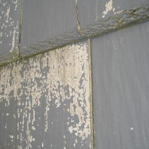

    Problems with Marley Eternit Monarch Tiles
    We contacted NHBC regarding the coating failure on the Marley Monarch tiles however they said that they could only act if there was a problem with the workmanship in laying the tiles not on the construction of the tiles. What were your Marley tiles and was the problem workmanship on laying the...
    The Marley Legal Group of eighty eight members from all over the UK has been complaining to Marley Eternit Ltd. and their solicitors over the last two years as a group about the coating failure on these Marley Monarch, Marquess & Marquess Duo Tiles. Many members have been complaining to Marley...
    Still fighting Marley after almost 5 years!

    Marley Roof Tile Discoloration - 5 yr old home
    Thank you for contacting the Marley Legal Group. Membership to the group has currently closed (July 2012) as we have so many members from all over the United Kingdom and we have raised enough money to commission a technical consultant's report via the group's solicitors on the Marley Monarch...
    Thank you for your interest and suggestion, however we have already considered this as a cause but it is not actually the cause in our cases - the problem is that the grey and red coatings have been failing on the Marley Monarch and Marquess slates/tiles. Marley's own site manager who inspected...
    Very interesting to note that your 12 year old Marley Monarch tiles have no fade to white - as you say Marley must have changed the formula of the coating and that was confirmed to me by Marley's previous site manager who said just that and that was the cause of the coating failure but Marley...
    What Marley tiles/slates and colour are the ones you are looking to replace? As far as I am aware from a builder who contacted me Marley have masses of both the Monarch and Marquess ranges but will not sell them as there has been a coating failure on both models. They have received hundreds...
    Hi Vicky, I am the coordinator for the 'Marley Legal Group' that is a group of people with similar coating failures on their Marley Monarch and Marquess roofs. If you wish to join this group that is currently seeking legal advice through appointed solicitors with offices in Scotland and...
    Just to advise anyone wanting more information on this subject in the Forum go to http://www.diynot.com/forums/viewtopic.php?t=250444. The Monarch & Marquess Tile coating failure seems to be widespead in Scotland. Marley have rectified some roofs, some have been agreed to be done and others they...
    An update on this situation. I have had a number of people contact me direct about having the same problem with their Marley Monarch Tiles. Interestingly enough one has a letter where Marley admit in writing that the problem is a 'coating failure'. However Marley have not yet rectified the...
    We have today contacted Trading Standards who put us on to www.consumerdirect.gov.uk and were told to fill in a standard template letter - they will tell you which one to complete by calling 08454 040506. You then have to send the letter by recorded delivery to Marley who have 14 days to...
    We have been told the same however it is definitely not just weathering and Marley are supposed to guarantee their tiles for 50 years. Reply saying their letter is TOTALLY UNACCEPTABLE and you will be taking legal action against them. They are just trying to worm their way out of their...
    Contact Phillip Wallis, Roofing Technical - Team Leader at Marley Eternit Ltd., the tile manufacturers, Lichfield Road, Branston, Burton on Trent, DE14 3HD. They are well aware of this problem, we are not alone by any means. We have been told that our roof is to be renovated some time this year...
