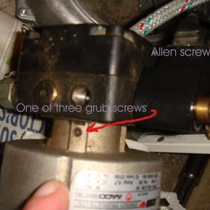

    oil pump on worcester danesmoor boiler
    The attached photo shows the position of the allen screw on top of the coil. Is the grub screw shown one of three which need to be released to remove the pump? I tried this but the pump seemed tight to remove and I didn't force it in case there were other screws inside the pump casing...
    I have a worcester danesmoor boiler with a Danfoss BFP 11 L3 pump on an electro oil inter 2011 burner. How is this fixed to the electric motor? Is it necessary to take the cover off the pump? Also, concerning the same oil pump, in an attempt to remove the solenoid, I mistakenly unscrewed the...
