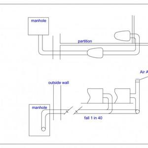

    New en-suite waste question
    Yes ofcourse I see that now. Would the addition of this air admittance valve suffice?

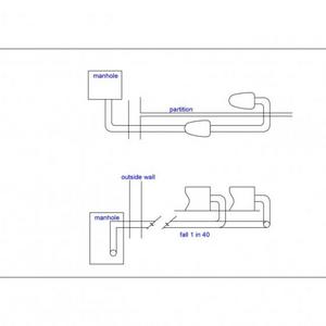

    Does this comply with building regs. Adding an en-suite next to a bathroom using a common pipe. Image in album
