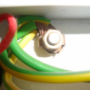

    phatboy thanks so much to you and PJ. I actually understand what you mean but just to make sure the thick wires will be put into this extra connector block. And a thinner earth wire from this extra connector and the earth coming form the wire in the wall will go into the earth connector on...

    Hi PJ first of all thanks for the response I have added pictures of both the new light connector block and a close up of the old earth wires. You will note that these wires are very much thicker than would be able to get into the small connector on the new appliance so I was wondering what can...
  4. Earth wires to bolt on old light
    You will note these earth wires are much thicker

    I thought wiring up a shaver light would have been ver simple but it would seem not. My old light fitted in 1992 was a metal box and when I have taken the back off there is the normal wiring for L, N and E which would be fine for my new plastic shaver light BUT there are also 2 additional...
