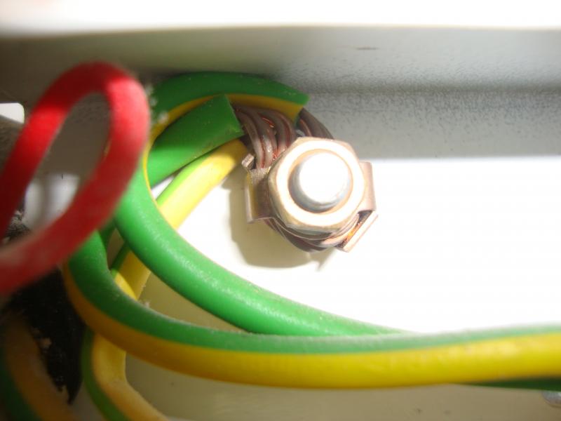

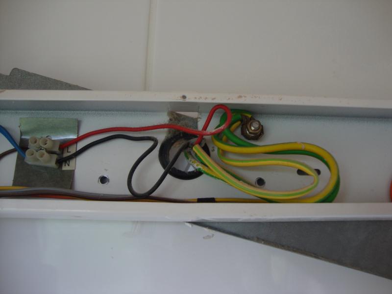

I thought wiring up a shaver light would have been ver simple but it would seem not.
My old light fitted in 1992 was a metal box and when I have taken the back off there is the normal wiring for L, N and E which would be fine for my new plastic shaver light BUT there are also 2 additional much thicker earth wires attached to a bolt in the back of the old metal plate.
I am not sure what these relate to one might be to the shower
My question is what am I supposed to do with these cables?
I have uploaded a picture. Any help would be much appreciated

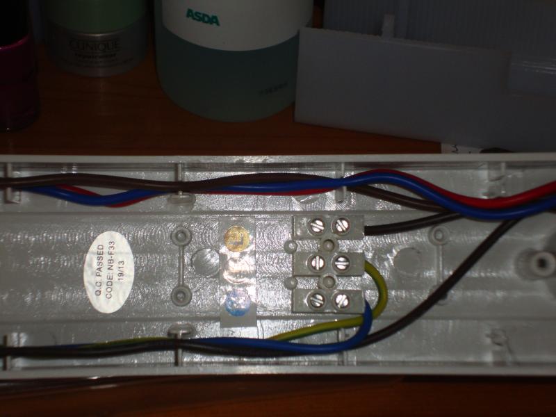

Hi PJ first of all thanks for the response I have added pictures of both the new light connector block and a close up of the old earth wires. You will note that these wires are very much thicker than would be able to get into the small connector on the new appliance so I was wondering what can I do?
These thick wires are the bonding for the plumbing in the bathroom. You should get a 30amp connector block, and terminate them into this. From this also take a short piece of earth cable, and connect that into the shaver sockets earth connection, along with the existing smaller earth.
This will keep things as they are now.
phatboy thanks so much to you and PJ.
I actually understand what you mean but just to make sure the thick wires will be put into this extra connector block. And a thinner earth wire from this extra connector and the earth coming form the wire in the wall will go into the earth connector on the new light
