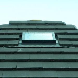

    Does this Velux sun tunnel look right to you???
    Sorry - forgot to say that you were right about the fitting instructions saying to leave a gap. Shame the Velux fitter didn't follow his own instructions when he fitted the one for the brochure. I'd also like to know what he did with all that flashing!

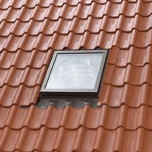

    Wow, you must be really easy to wind up - I bet your mates have a field day!! Either that or you don't have the visual/mental capacity to understand what I'm talking about. Let's play a simple spot the difference game: Velux brochure pics (ok - not exactly the same tiles but I think we can...
    Hi, Just having a debate with the roofer about the finished look of this 14" Velux sun tunnel with flexible tube. I confirmed with Velux that this is the correct model to use for the Marley Modern tiles so that is not an issue here. What do you think? In my opinion the...
