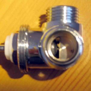

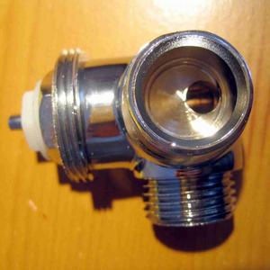

    Bi-directional TRV body - no flow arrows?
    Now you come to ask............... :wink:
  2. C
    Found new info which fully clarifies this for me... even though it seems to annoy others....... "The Elegance TRV is specially designed for installation on either the flow or return pipework, in any orientation and with the flow of water in any direction" Sorted - End of discussion, and...
  3. C
    As I understand it - the flow arrows are there so you can put the body the right way round at the installation phase. I have used Danfoss ones before where you rotate a sleeve to suit either flow or return pipe use of the valve. Looking again at the description of the one in question, it...
  4. C
    Why do most have flow arrows then?
  5. C
    Just bought a new bi-directional TRV to suit a new radiator. There are no markings on the body to indicate which way the flow should go. The supplier assures me it doesn't matter, but I always understood it does. Advice appreciated. I have two pictures of the valve to help, one end...

  8. Bi-directional TRV body without arrows
    Pictures of both ends of a bi-directional TRV which doesn't have any flow arrows.<br>Supplier says it doesn't matter - I dont agree....
