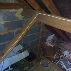

    The SE has been and had a look. NO steel required. Just waiting for his design now and then submitting through Council..

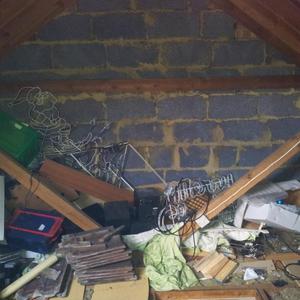

    Hi No the 4x2 is what is already in the loft (i.e before i start) I said : 'I will also need to take out the struts (and binders) after adding additional strengthening. Was thinking of putting additional 6x2 times 2 bolted together under the purlins and adding verticle supports. the...

    Hi, yes i will be using 8x2 for the beams now as i agree 6x2 is too small. Thanks

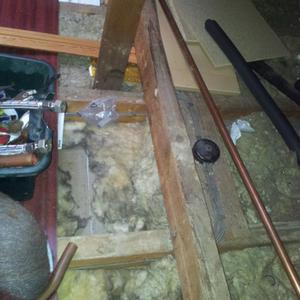

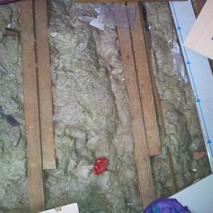

    ok thanks have emailed the structural engineer so will await his response. Just to add the joists would NOT run the total length. I would run them width ways overlapping in the middle over a structural wall below.

    Hi, I am in the process of doing a loft conversion I have installed a velux and now want to do the floor. I have a 3 bed semi and want to add a useable room. The house is a 1950's build. It is a 'cut roof' and has the joists running width ways with purlins and binders...
