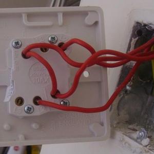

    Replacing conventional switch with a dimmer.
    I want to replace a conventional 2G 1W switch with a 2G 1W dimmer switch. When I opened the old switch I was faced with the following wiring... Why is there a connecting wire between both L1s? Is it because the switches are on a loop? To replace this switch with a dimmer - Is it...
