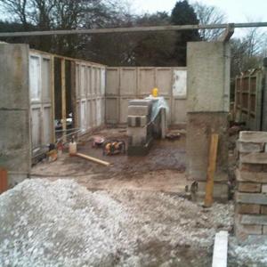

Im in the process of building a garage, its 3600 wide x 7800 long.
Ive got the walls upto nail plate.
Im a bit stuck with the flat roof joist joinery. Im after creating an overhang at the sides of 300mm, easy, oversail the joists.
Im looking at using a lookout rafter on the front...
