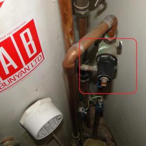

    Need help identifying a leaking Megaflow part (pics)
    Thanks for the quick answer Tony. Chris R, or any other guys qualified to work on unvented systems, I am in the Woking area, please let me know if you fancy the job.
    Hi All, I have a minor leak in a component which I can't identify on my Megaflow system. I first thought it was some kind of pressure relief valve, but there is a more obvious one of those directly before it in the flow. It's on the inlet pipe for the hot water supply - the pipe just drops...
