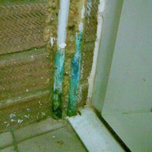

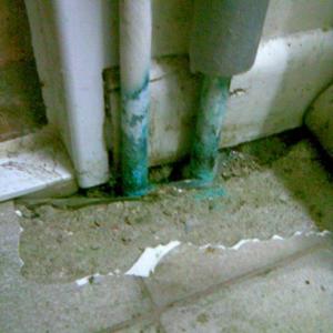

    Blue/green powder on outside of copper pipe.
    Thanks Gents, It sounds like its not a major problem, so i'll only re-route the pipework if/when a leak does develop. We're planning on giving this extension a facelift in the next few months, so I'll just give the pipes a gentle clean to get rid of the powder and give them another coat of...
  10. D
    Thanks Herts, I've no idea whether the pipes are protected in the concrete, but I can't see the end of anytape or protective sleeving, so I'm guessing not. Ok, something else to add to my "to do" list.... :D
  11. D
    Hi all.... I'm wondering if some of my copper pipes are getting corroded where they enter a concrete floor, and should I be thinking about re-routing the pipework? We have an extension which, i think, used to be the old outside toilet/coal shed, (1950's ex council house). This extension...
