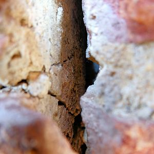

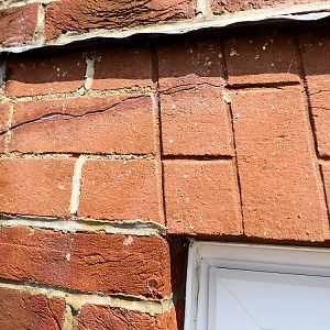

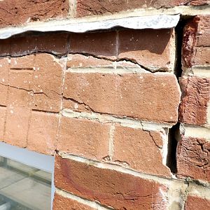

    .. I think. Scaffolding is up to have the roof felt and tiles replaced so a chance for a good look over those areas not normally easy to reach. That's when I had a good look at this lintel. At one point, during a storm, we had water come through the inner wall either side of this lintel, cavity...

    Bedroom_Lintel
    Right end of lintel- I removed mortar- cracks onthe face

    Bedroom_Lintel2
    Left hand end of lintel with crack prev filled with silicone

    Bedroom_Lintel3
    Interior end of lintel, not very clear but may be of use.
