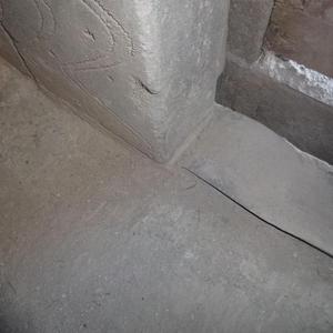

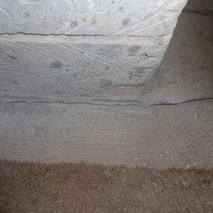

  5. DPC Woes
    DPC Woes
    Pics of how my 'professional' Cornish builder has used DPCs which are too narrow!! How am I supposed to be able to tape my damp proof membrane to this? These are walls sitting on a slab which sits in the earth. The man has a lot to answer for.....oh the house is 250mm too low in the ground...
