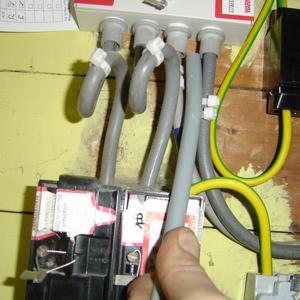

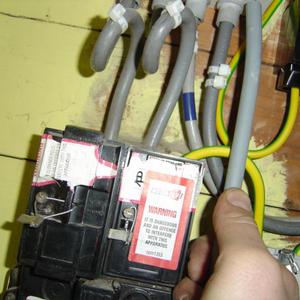

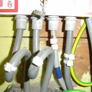

    Earth Connection Upgrade?
    here they are
  2. D
    Better photos for comparison. A 25mm tails cable held up to existing system. uploaded to 1st album
  3. D
    Thanks all for your comments. Away from home till weekend so will have a closer look at the labels then. My somewhat useless initial photos were of a TN-S. The main earth cable was attached to the cable just before entering the cutout, with an earthing clamp. I requested the system to be...
  4. D
    Ok. old photo not good but what do you make of the latest
  5. D
    Hi All, Could anyone please tell me what to make of this (See uploaded Picture). Just had, what I thought was a conversion from a TN-S to TNC-S earthing. Or have I now got a combination of both. When I got home...
