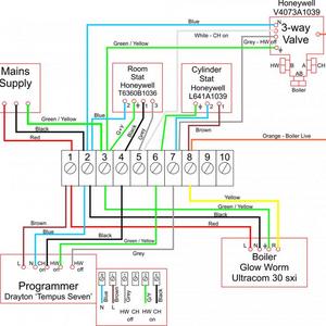

    3-Way Valve not Working Correctly - Wiring
    So a piece of the kit is screwed ! - Thanks
  2. D
    Have deleted my first album and replaced - try now :)
  3. D
    Had a bit of a problem uploading, but you should be able to see the new diagram now :)
  4. D
    Hi, I've updated the diagram (CH Wiring3). bazdaman; picasso; D_Hailsham & jeff the gasman - appreciate your help. With hot water on there IS power to the grey wire on the motorised valve (terminal 7) ! By switching off the power and then turning it on again I find; HW on...
  5. D
    Thanks. Updated diagram uploaded. Yep I have a multi-meter (but not used it !)
  6. D
    Sorry album seems not to be working properly My Albums Link: http://www.diynot.com/network/dbleman/albums/ Thanks
  7. D
    They say YES James ? and no it has never really worked.
  8. D
    Hi, can anyone help please. I have a Honeywell 3-port valve V4073A1039; Honeywell Room Stat T6360B1036; Cylinder Stat L641A1039; Drayton 'Tempus Seven' programmer and a Glow Worm Ultracom 30 sxi boiler. Everything works except the hot water. The 3-way valve head gets hot (even when the...
