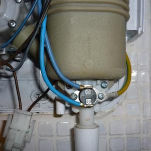

    thanks for your help ........ yes, the brown wire to the tco is burnt, I noticed that.....would that indicate there is a problem? thanks again

    previous post should read 'outlet tco'

    I checked the tco and heating elements with a multimeter. Problem is i'm unsure of exactly where to touch the testing ends.... For the tco I held an end on each of the two blue cable terminals and got continuity For the heating elements I wasn't exactly sure.....would someone have a diagram...

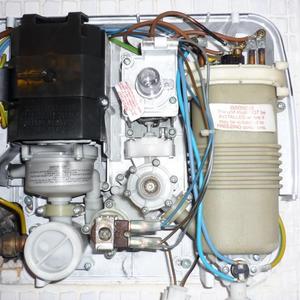

    I checked the shower earlier today and there was nothing obvious at the TCO or other parts, see photos below. I tried the shower a few times with different settings and got the same results each time.....turn temperature gauge to lowest setting and the water is cold with very high pressure...

    Hi I have a Triton T90Si electric shower which recently hasn't been heating the water to the required temperature. All the settings for hot water provide only tepid water. The shower is about 6 years old. Anyone any idea what the problem might be? Many thanks
