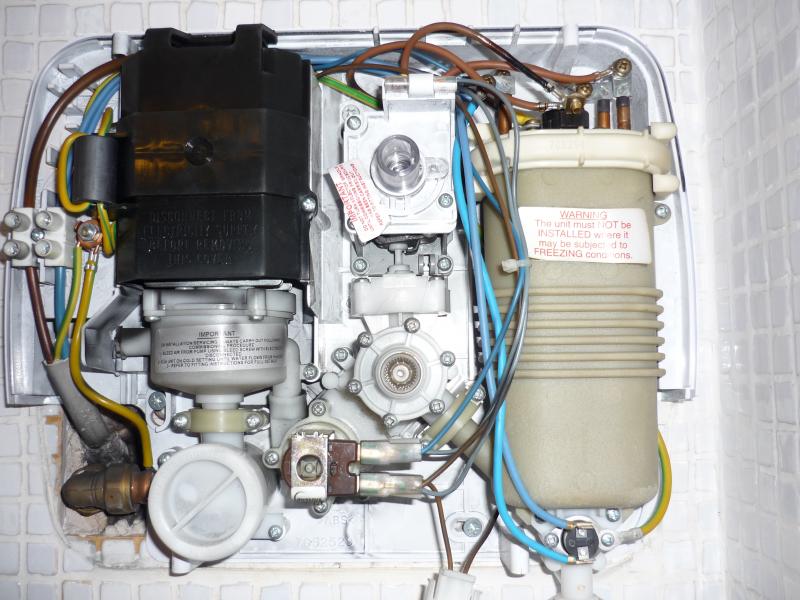

I checked the shower earlier today and there was nothing obvious at the TCO or other parts, see photos below.
I tried the shower a few times with different settings and got the same results each time.....turn temperature gauge to lowest setting and the water is cold with very high pressure, turn temperature gauge to highest setting and the water is tepid with very low pressure.........any ideas? I didn't have a multimeter so didn't check for continuity at the TCO

whats going on with the brown to the top tco looks burnt to me.
thanks for your help ........
yes, the brown wire to the tco is burnt, I noticed that.....would that indicate there is a problem?
thanks again
it doesn't help and if it totally fails you will loose all heat.
if i remember you have 2 wires to that side of the tco and 1 from the rear where the yellow connector is.
you may find one of the elements isn't getting power due to the burnt wire.
