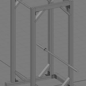

    Wooden Power Rack for outdoor gym
    I'm nervous of using treated (tanalised??) timber as I've read in a couple of places that the chemicals can be harmful. The timber that I'm planning to buy is £1.47/m 4x2, is that unreasonable? I'm itching to start building this but I'm not feeling confident about my choice of materials and...

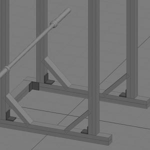

    Hi. I'm about to start building a power rack that was inspired by this design: But I need to use it in the back garden since there's no room in the house. This is my design to make it as cheap as possible: Any feedback on weak points would be appreciated. The timber is from here...
