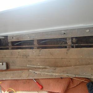

    radiator query
    OK - half way there! the upstairs has the rads in series and each rad has a pipe as in the above photo which connects across the inlet / outlet of the rad. the suspicious looking extra pipe on the right side of the photo (heading down on the pic) actually is a tee to feed the rad in the...
  5. D
    radiator query
    thanks for your help on this guys. on the left and right of the of the pic you will see the vertical pipes which join to the rad. further left than the left side rad feed pipe, there is another underfloor pipe (going down to bottom of the picture) which has travelled the length of the room...

    radiator query
    hi guys, in the middle of a big renovation of my house and fitting new trendy rads but have a strange issue. i've seen this when replacing radiators downstairs and wondered about it then but now its got me confused. there are two pipes going to the rad as usual; supply and return but...
