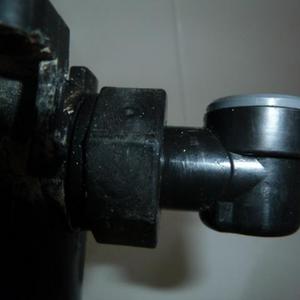

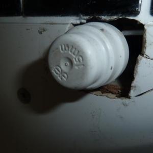

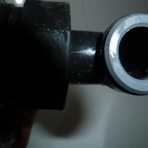

    Shower Leaking - Plumbing Advice needed
    Yep I think I am going to lose some of my formerly pristine tile work. I suspect that the projecting pipe is a bit short altho he's denying that profusely lol. The pushfit stop cap is stopping water but he says only just.., u have to get it in the right position to prevent leaks.
  2. D
    The joints are pushfit not compression. OH has been told by a plumber friend that he needs to use a blow torch to unseal the joint behind the end capped pipe, put in another length of the pipe protruding from the wall and attach the gainsborough elbow joint to that.
  3. D
    Hope these give enough detail. Yep he's broken a tile. [/img]

  8. D
    I have redone my bathroom (tiled) .., moved water pipes etc. I have a combination boiler so its a pressurised system as far as I understand it and have reused a Gainsborough thermostatic shower. Unfortunately when I connect the Gainsborough elbow connectors (the elbow joints are brand new)...
