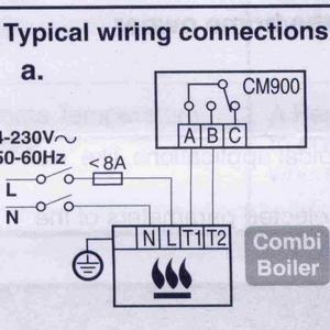

    I have had a go at pasting the wiring diagram from the thermostat.

    Wiring
  7. D
    Programmable thermostats
    Ok I have purchased a CM907 thermostat but the wiring is different from that suggested above. The boiler has 3 connections for the room thermostat marked RN - Neutral, RI - Switched Live RL - Live (The existing thermostat is connected to RI & RL) and 3 connections for the existing...

    Cheers Fitz, thanks for the help. Do you know if the Honeywell CM907 would be suitable?

    Does that mean I could just replace the thermostat with a programmable one, and if so would I just leave the manual timer on constant ?
  11. D
    Hi, I have a Worcester 28i RSF combi boiler with a manual timer and a Danfoss room thermostat that is connected through 2 wires (I presume a live and neutral). My question is, can I simply replace the room thermostat with a 7 day programmable thermostat such as the Honeywell CM907 ? Would any...
