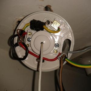

    its a 2 way which i think is why it now trips when connected the way the old one was. this one is labelled L1(where the N wires are) L2(where at the top of pic and Common on the right of pic. checked iso wiring and fan, all correct as in instructions
  5. D
    no permanent live for bathroom extractor
    ive not reconnected the 3 and E from the iso in this pic, but im wondering if the new pull switch is layed out differently.
  6. D
    i didnt wire it until now so i would have daylight should this happen. AARRGGHH. Ive put a new pull switch on as the old ones N terminal had no grub screw, will put up a photo.

    well Ive got everything up until the pull switch connected just not sure what to do there. I have a common, live and earth terminal being used and a redundant N terminal. Do I put my black sleeved brown to the live brown to common and grey sleeved blue to neutral? as the fan is double...

    thats good i have bought that very isolator. where my neutral is not connected in my pull switch (just looping through) should i cut and bare it to join all 3 N into the switch N terminal. thanks by the way, Dom

    will try and get a photo up soon, but it is likely that it is the last light where it is. to explain it better though there is a live into the common and a live into the live terminal but the N terminal is empty just a N wire running into the switch casing and back out (looped) not bared off...
