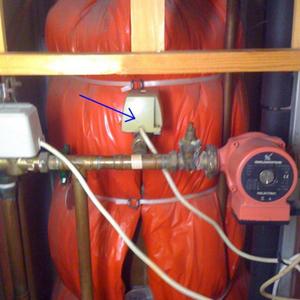

    Ok Thanks Everyone for the suggestions. Managed to solve it by running the hot taps for a while after bleeding the valve to the right of the pump. Hot water ok now. Thanks again everyone!

    Hi Tony, I dont think so. its one of these...
  3. D
    Changed an Actuator Valve now no hot water!
    There is one to the right of the pump. Any good?
  4. D
    So to try that I need to turn the hot water on then turn the big metal screw in the pump? Sorry I'm a complete amateur!
  5. D
    I made a drawing of the original wiring and the new valve had 3 wires the same coluor as the old one so i copied the original layout with regards to where they went. but two were different colours so i must admit i guessed where they went (although one of them i know was supposed to go to the...
  6. D
    The thermostat is not on the floor its kinda strapped to the tank about 6" above the floor. it's currently set at 70deg C
  7. D
    The picture shows the old valve before i replaced it. Sorry should have mentioned that
  8. D
    Hi and thanks to all of you who have replied on this busy day! Spraggo, the pipe between the 2 actuator valves that goes down goes to the hot water taps in the bathroom. the pipe going down to the left of the left actuator valve goes under the floor and I have no idea where it goes.
  9. D
    Please can anyone help on this cold Xmas Eve! I Live in a flat, We have 4 radiators, a potterton Kingfisher boiler and a header tank (At ceiling height) above a primatic cylinder. Yesterday the actuator Valve that I believe feeds the DHW into the primatic cylinder failed (Lots of clicking...
