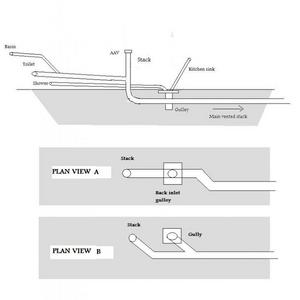

    Drain design puzzle
    Excellent Hugh, so it sounds like I have more options than I thought (that's the problem with not knowing where the written rules can be bent/broken). I'm actually quite taken on the gulley approach if it's possible as it would mean if anything did go wrong with the drain, any blockage...
  2. Untitled
  3. D
    Drain design puzzle
    Thanks John, Hugh. John, the falls should be OK, it's that 450mm minimum on a stack that is the problem for me. But thanks for the reassurance, building control scares me, but it does mean I'm learning new things! Hugh, this is all external, and I'm hoping to avoid an internal stack and...
  4. D
    Drain design puzzle
    I'm hoping someone can help me, I'm coming to the end of an extension project and I'm having trouble figuring out how to squeeze the waste pipes of a new en-suite into the drain. I hope my explanation isn't too long... The drain has been extended from the existing drain by the builder who...
