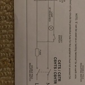

    Thinking out loud. By reference to the wiring diagram (image), and to the thread here: https://www.diynot.com/diy/threads/has-my-builder-f-ed-up-the-wiring-to-my-bathroom-extractor.240947/ Would it be a stupid idea to connect up the T to the L with a spare bit of wire? Is that dangerous in...

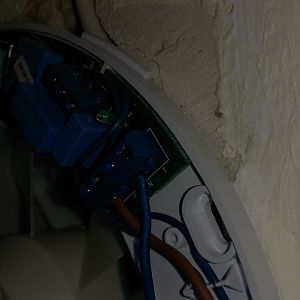

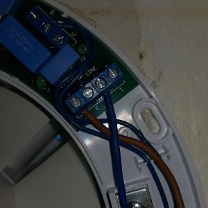

    Here's what it looks like. The humidistat is attached to the blue cable on the left. The humidistat potentiometer is the blue cylinder on the left, the timer potentiometer is the one on the right. The timer is set to its minimum of 30s, so theoretically I think it should run for 30s after the...

    Another piece of the puzzle. Today plugged the humidistat back in and it started straight away, which was good because I was about to have a shower. Post-shower, most of the steam gone, I unplugged the humidistat again. The fan stopped straight away whereas the other day it carried on all night...

    No they're the right way round, TNEL as on the instructions. Better pic here (if a bit dark) IMAG6015 by ercole89 posted 29 Sep 2017 at 9:53 PM

    Hmm, the wires are going into the right boxes. I was hoping it would be an easy fix but it seems something else is going on. IMAG6013 by ercole89 posted 29 Sep 2017 at 9:13 PM The wiring instructions are below and there is also a paragraph that specifies 3-core in the written instructions...

    Hi, I realise there was a similar question earlier this week but my problem is slightly different. I'm not an expert/electrician so go easy on me if I say something stupid! I have an Xpelair C6HTS humidistat+timer fan which replaced a simple on/off pull switch operated fan (not connected to...
