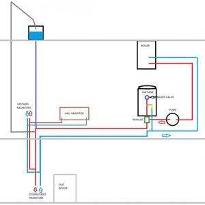

    Gurgling system but vent pipe is after pump
    All, Since the cold weather really kicked in I've been plagued by air being drawn into my system and waking my 2 year up in the morning too early! I've taken up carpets tonight to figure out the exact layout (see below). A couple of years ago I paid for a new Worcester boiler to be...
