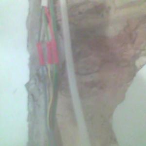

    how to repair cables drilled through doing shelving?
    thanks for all replies - I did buy a ratchet crimping tool, had to practice a bit to get a good tight connection. The two damaged lighting wires are 1.mm, I have cut out a section about 1m long of each and put a patch in using 3 red crimps and the self amalgamating silicone tape. I have some...
    thanks TTC will nip out and get the crimping tool and ask about the heat shrink or self amalgamating tape, glad I asked - was thinking of screw down connectors
    Can't believe how stupid I was - used a wallscanner that gave no reading for electric, but clear reading for metal, somehow thought if it was a cable it would register as machine was pretty good at picking up live wires from lightswitches, should have chiseled off some plaster before drilling to...
