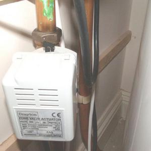

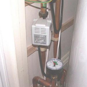

    have now done as you have suggested. THE LEVER IS IN THE LEFT POSITION AND THE LEVER ON THE SIDE REGISTERS B AND ITS STAYED IN PLACE!!!!!!!! I noticed THAT THE BAR pressure HAS INCREASED FROM 1.5 TO 2.5 WHILST I HAVE BEEN MESSING WILL KEEP MY EYE ON IT. DO YOU THINK I NEED TO GET SOMEONE TO...

    have noticed on the RHS of the unit there is a very small lever and it is in the A position as the lever moves across the top of the unit the lever on the side moves from A to B If I were to tie the lever on the top in one place would it be to the left or the right. I can fix it with elastic...

    I have just posted a picture for you and it is the black lever at the top that slowly moves from right to left. When it gets to the left it springs back with a big noise I think its marvelous that you are helping..it shows there are some good samaritans out there...at least one Maureen

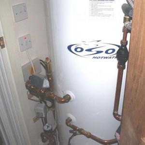

    [/url] john apologies in my panic I ddi not put pics on sorry you know whaT WOMEN ARE LIKE Mo

    The system is 5 y.o. this is the hot water part I think. the boiler is downstairs. see pic this zone v.a is clicking ...I have the central heating on. when just the water it stops. I am at my wits end female with family and now no central heating its 'freezing' cant get a plumber at the...
