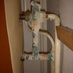

    Storage immersion tank all electric
    Thanks-So What do I need to order specifically for new tank (what's it full description if I go online to check). Also I have this valve on the side of the tank that is all corroded, do I still need this with new tank? and what is it for? (check my album for pic) Thank you for your reply and...
