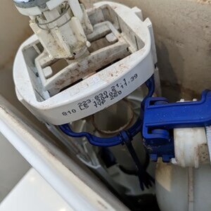

    Removing Geberit flush valve
    Thanks for help, now sorted. After a lot of struggling, I eventually managed to turn it enough for it to lift off. Couple of very large water blisters on the seal which i popped and it's now working fine.
  2. G
    Sorry to bump, but can anybody help?
  3. G
    Seal needs replacing but I can't for the life of me remove the valve. I don't think it's a clip on, but I can only turn it maybe 20 degrees in either direction. Does anyone know how to remove it? Cheers.
    geberit 223.830.21.1
