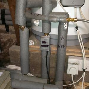

    It's the boiler pressure that goes from 1.0 to 1.5. The expansion vessel itself doesn't have a gauge, but the PRV in line with it goes from 1.1 to 1.2 when boiler is firing.

    When the boiler is at rest it is showing pressure of 1.0. When it is firing it is showing 1.5b. Does that point even more to the expansion vessel?

    OK, I have double checked and tried to label everything. You're right (of course). The expansion vessel is on the primary return. So it looks like this could be the culprit for the pressure changes which makes sense if it goes from 1.1 to 1.6 and then back down again (currently static at...

    Dan, This is a Megaflo: I understood the expansion capability was built in to the tank with an air gap? I had assumed the expansion vessel was for the secondary circulation. If I understand correctly, this circuit is to allow the hot water to be circulated around the system so that there is...

    @Dan_Robinson: pictures attached; please let me know if there's more specific things you need. @newgasinstaller: The installers were a professional G3 qualified company and Remaha themselves commissioned the boiler. But that doesn't necessarily means that all is correctly done! I have put...

    We have recently had fitted a Quinta Pro 45 with a Megaflo 300l in a completely new installation (i.e. all new pipework etc.). This is feeding a house of 3000 sq ft with four occupants. Unfortunately, though, our installers have gone AWOL and we are unsure how the system should work. In...
