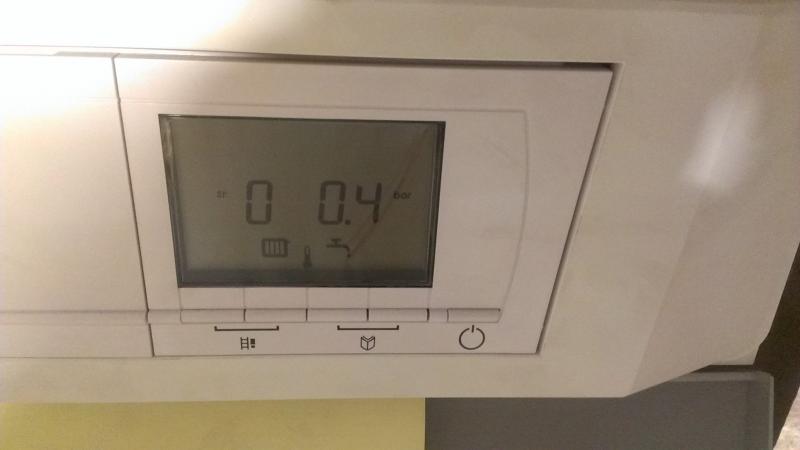

Every now and then we experience a catastrophic loss of pressure in the system. The boiler display will show 1.1B for a few weeks then drop to 1.0 or 0.9 over a couple of days and then suddenly drop to 0.5 or 0.4B complete with the "top up" warning. Can you explain to me how this can be? Where can the water from this sealed system go to? There are no obvious leaks.
I manually top up the pressure to 1.1B. No matter how long I have the tap on, it seems that the pressure will not go above 1.1B However, several hours later the boiler will show a pressure of 1.6B. How can that be?

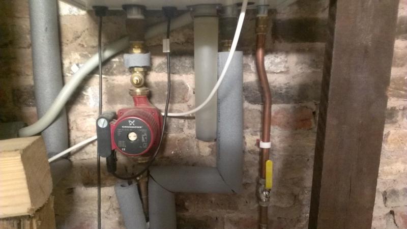

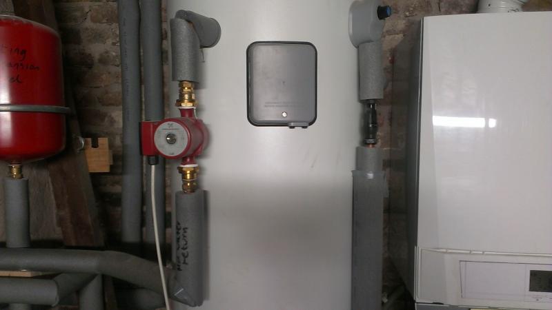

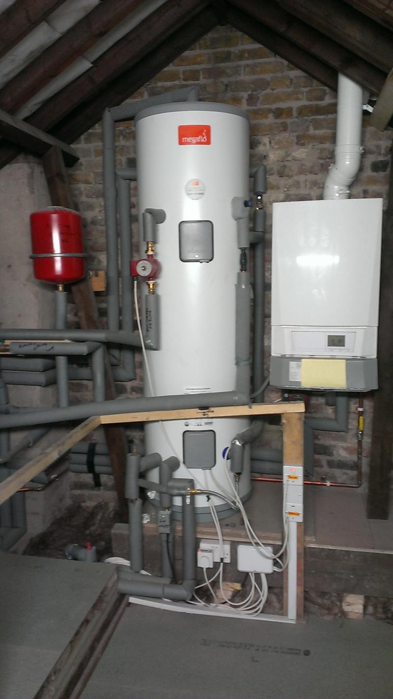

@Dan_Robinson: pictures attached; please let me know if there's more specific things you need.

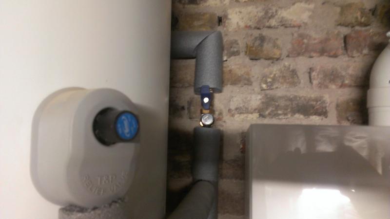

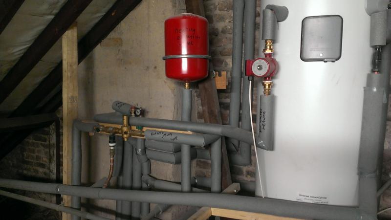

@newgasinstaller: The installers were a professional G3 qualified company and Remaha themselves commissioned the boiler. But that doesn't necessarily means that all is correctly done! I have put some absorbent material in the tundis to see if anything is leaking there overnight. The expansion vessel is pretty large (see pictures) but I'm not sure how I test if it is healthy or not.
Is it an 18 or 25 litre expansion vessel? It is going to be too small IMHO.
I would be thinking of adding another as well as double checking the charges - which is explained in the FAQ section.

This is a Megaflo: I understood the expansion capability was built in to the tank with an air gap? I had assumed the expansion vessel was for the secondary circulation. If I understand correctly, this circuit is to allow the hot water to be circulated around the system so that there is not a long wait for hot water at the taps. The expansion vessel is 18l. There is no pressure gauge on the expansion vessel. Given that, could this still be a factor?
I will see if I can check the charges on the main Megaflo air gap.
Dan is probably right on the money. For a larger system especially with UFH, which has a lot of water in it, the vessel looks on the small side.
The expansion vessel is red therefore is central heating, nothing to do with the Megaflo - which as you say is a bubbletop (leaks only start on these after around 24 months once the bubble gets diminished)!

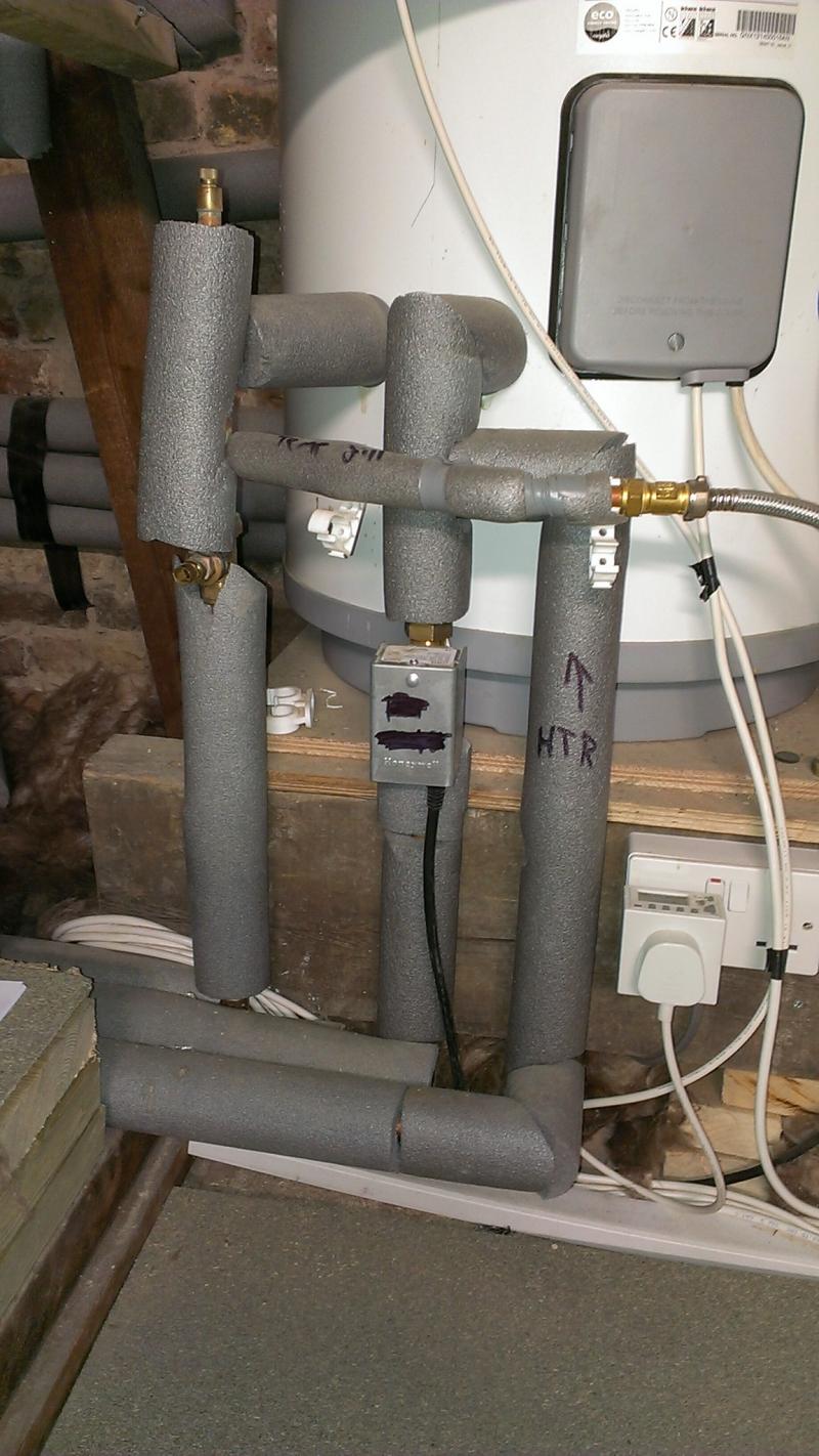

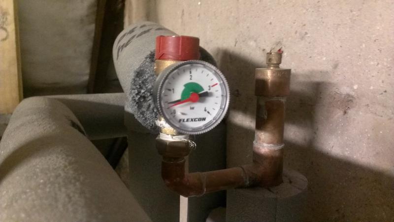

OK, I have double checked and tried to label everything. You're right (of course). The expansion vessel is on the primary return. So it looks like this could be the culprit for the pressure changes which makes sense if it goes from 1.1 to 1.6 and then back down again (currently static at 1.0). What size expansion vessel would you recommend? There is a PRV and gauge on the same circuit which shows the same pressure as the boiler is showing (currently 1.0). Should there be an additional gauge on the vessel itself monitoring what's going on inside?
As a secondary question, I'm confused by what is happening around the primary flow to the Megaflo. as you can see here
there are two connections to the primary flow: one before the two port motorised valve and one after. I believe the one after is something to do with the heated towel rails (which should come off the primary) as this was one of the few pipes labelled as "HTR Return". Is this just an error in labelling, i.e. it should be HTR flow. But why is it located before the 2-port? And why can I not see a corresponding HTR return?

When the boiler is at rest it is showing pressure of 1.0. When it is firing it is showing 1.5b. Does that point even more to the expansion vessel?
If the exp vessel is running between 1.0 cold and 1.6 when the boiler and all rads/UFH circuits are up to temperature - this isn't the cause of your pressure loss.

It's the boiler pressure that goes from 1.0 to 1.5. The expansion vessel itself doesn't have a gauge, but the PRV in line with it goes from 1.1 to 1.2 when boiler is firing.
The pressure on the boiler should be the same as the expansion vessel, so you are not likely to have a fault with this as explained earlier.
