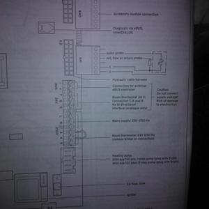

    how to wire salus rt500rf to valiant eco pro tec
    Hello can sone one please help. Wired as per lectricians diagram receiver takes signal as it clicks and green light indicates on but boiler doesn't fire up.
    Hello Thier is no current CPC in existing thermostat and no terminal in the receiver unit.
    Ch - haha Oops Have to get some 3 core and earth then. Making the earth redundant. Is that right. Thanks.
    hello lectrician thanks very much for your time and knowledge. i believed it was concerning 3 and 4, wasnt sure about the link between com and l. now i can see you must be correct. was you aware of this info or did you calculate it. would you use 3 core plus earth (cutting back)? or 3...
    hello this ishttp://media.diynot.com/212000_211333_69209_62820703_thumb.jpg the wiring diagram.
    hello really appreciate that last effort but the wiring diagram for mine is different version no x1. i will upload photo now if possible. thanks
    hello thanks for your fast response. i found these but i fail to understand the current thermostat goes to 3 and 4, from what i know, 3 goes to com and 4 goes to no but can i not get a live and neutral from the boiler. for the receiver mains.
