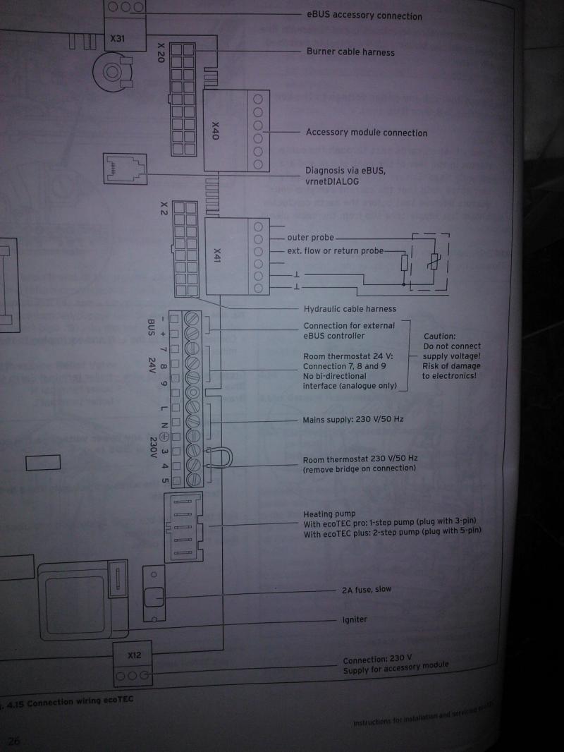

can someone please help me on how to wire a salus rt500rf to valiant eco pro tec

i found these but i fail to understand the current thermostat goes to 3 and 4, from what i know,
3 goes to com and
4 goes to no but can i not get a live and neutral from the boiler.
for the receiver mains.

really appreciate that last effort but the wiring diagram for mine is different version no x1. i will upload photo now if possible. thanks
if some one is able to transpose that wiring i would really much appreciate it.

As above, but RT becomes 4
3, 4, 5 is live out, live back, neutral.
3, L
4, RT
5, N
Well, eventually
you remove the link between terminals 3 and 4 and insert the wires from COM and N/O on the receiver.

i believed it was concerning 3 and 4, wasnt sure about the link between com and l. now i can see you must be correct.
