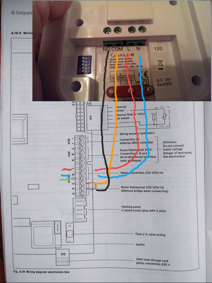

Hi all,
Just wondered if anyone can confirm if this photo is the correct method of wiring a rt510rf stat to a vaillant eco tec pro 28 combi.
And then remove the link.
Many thanks
I cannot find the same diagram in the instruction manual on line.
If the link was between terminals 3 and 4, then you would appear to be correct.
I presume the supply is connected to the L, N & E in your picture.
Yes main supply to l,n,e.
And the link is in between 3 and 4.
So just run live to l
Netral to n
3 to com
4 to no.
Many thanks.

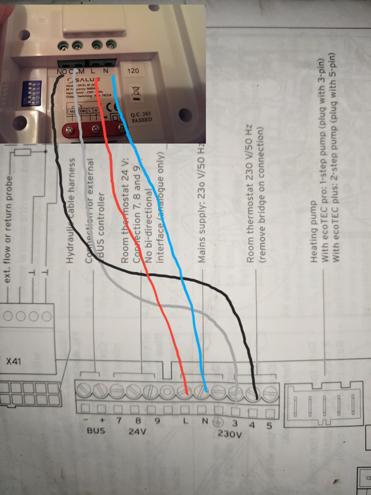

Found a better photo with link in.
