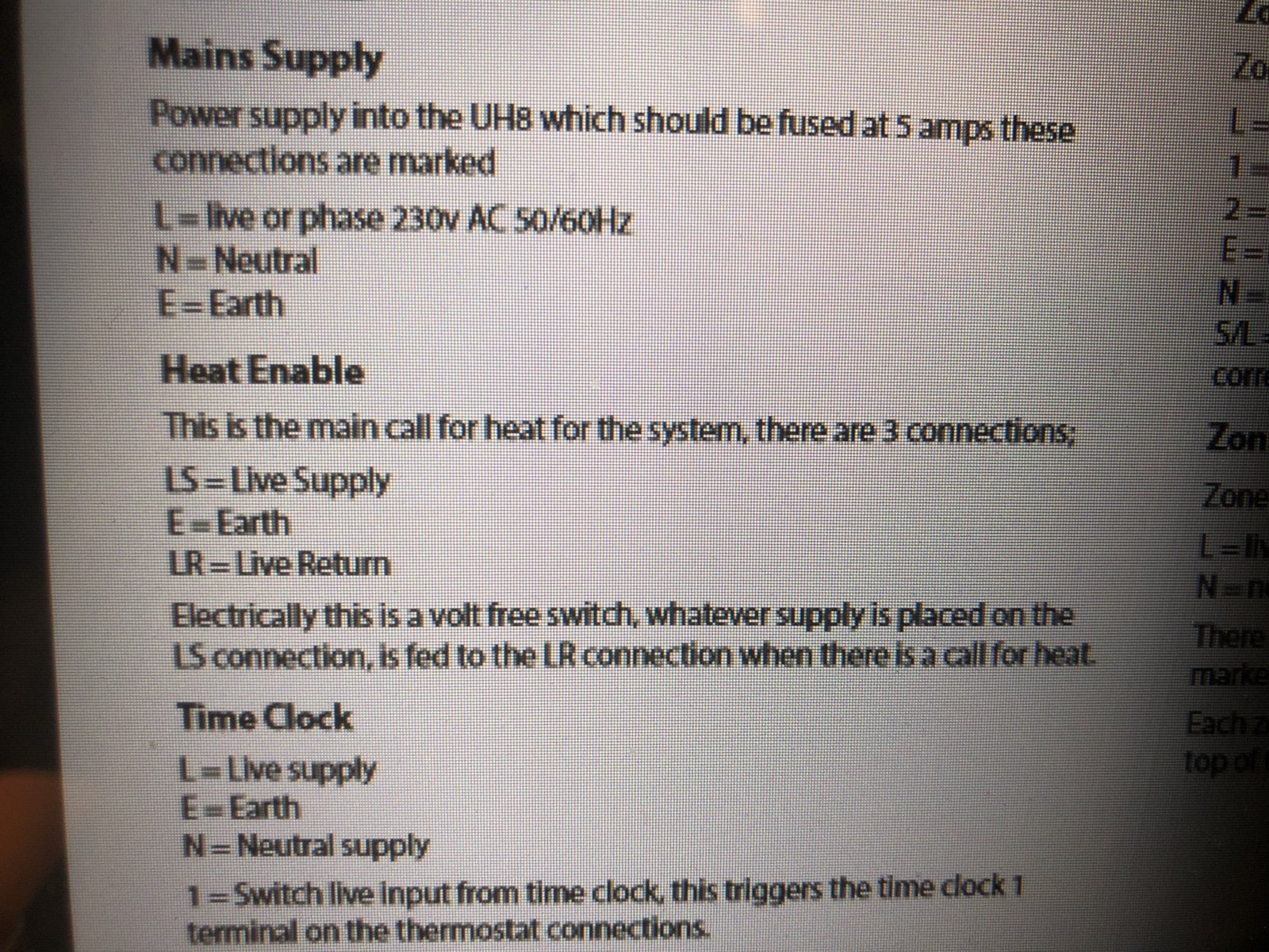

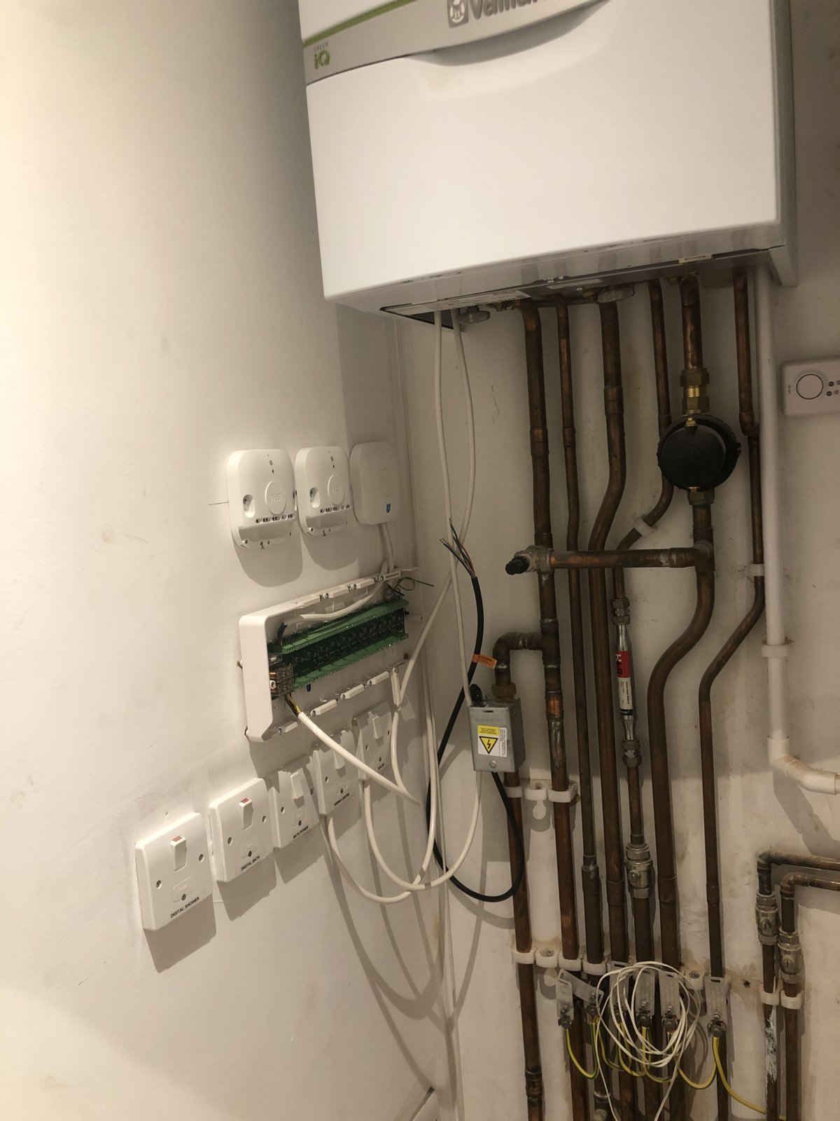

Stem, I need to wire the boiler into a wiring centre and it wants it to be done 'volt free'. Can you please advise? Which ports on the boiler should i use? I have the same boiler as pictured above
If it's the same boiler you do it exactly the same. It is the thermostat switch contacts that are described as 'volt free' which means that aren't connected to the 230V supply and they will switch any voltage that is applied to them. So they can be used with 230V or 24v. In the case of the example above it's 24v.
It's unusual though to have a wiring centre with a combi boiler though. Is that what you mean?
They are normally associated with systems that have a hot water cylinder or several heating zones and are fitted with motorised valves. If that is the case the installation is completely different, the thermostat controls the motorised valves and not the boiler directly.

So I can wire into the 230V RT (Pinky terminal next to the mains power).
I have an under floor heating system and a separate radiator zone upstairs. I’m using the Heatmiser under floor heating 8 zone wiring centre

Sorry I have no experience of a 'Heatmiser under floor heating 8 zone wiring centre' so can't give specific advice on that I'm afraid.
However, for multi zone installations with motorised valves, the thermostats or Nest Heat links in your case, will control the motorised valves (not the boiler) In turn the motorised valves control the boiler (via their grey and orange wires, which are connected to a voltage free switch inside the valve) These wires can be connected to the same two 24v boiler terminals, or if you prefer instead, the grey wires can be connected to a 'Permanent Live' and the orange wires can go to the "pinky terminal"
You should also know that access to that particular boiler involves removing a cover that is part of the combustion circuit and is therefore subject to relevant safety checks.
