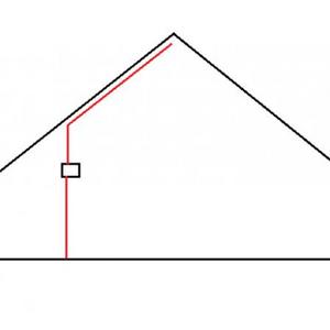

  5. G
    Running cable to attic lights and smoke detector
    Just spoke to the local building control. I conceed, i have been misinformed but i do think it is because i was working under him at the time so he obviously trusted my work. My apologies for that and thank you for correcting me, saved me valuable time. The BCO did however say i can...

  7. G
    Just to clarify this is the only part that will not be visible, the red is 20mm conduit which can easily have cable pulled out again. Everything i plan to run under the floor is very easy for him to inspect as i have put plenty of access hatches (one at every fitting or terminal) with round...

    Hi I am running cable in the upper floors of the house at the minute, i wont be getting them connected and signed off till after the new year so i have no sparky to consult. I have worked for a couple for sparkies in the past but i am a bit rusty on the regs (plus one was a bit of a cowboy...
