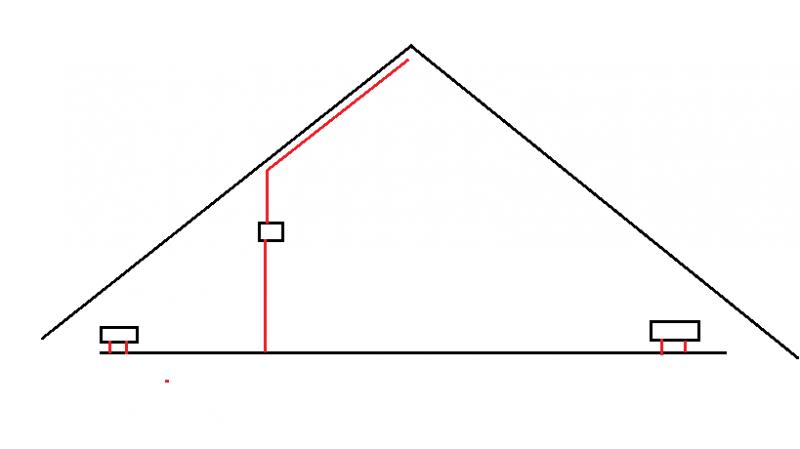

    Hi
    I am running cable in the upper floors of the house at the minute, i wont be getting them connected and signed off till after the new year so i have no sparky to consult. I have worked for a couple for sparkies in the past but i am a bit rusty on the regs (plus one was a bit of a cowboy and didnt care).
    At last count i can only run cables through a wall within 150mm of a corner or horizontal/vertical from a fitting. Is this still correct?
    I fitted single 25 mm round conduit behind the plaster board running up to a 35mm knockout (dimable light switch) and again out of the top of it running to the corner of the ceiling (which then follows up to the ridge).
    I now want to fit smoke detectors so i can rent the house out in the future.
    Can i run the additional wiring for the smoke detector through the same conduit? It will mean running the cable through the same knockout box as the switch to reach the terminal box under the floor, this is what i am unsure of.
    I will be rigging the smokes to the light circuit. I have seen it done [passing extra cables through a knockout] but unsure if it conforms to the regs. If it is fine, is the box deep enough for the extra cable to pass through and a dimmer? If not i am going to have problems geeting the cable up there within safe zones.
    Also the light circuit will be a 3 way switch, from memory i had planned for 2x 1.5 mm cables to be running from the floor to the switch and 1x 1.5 to be running from the switch to ceiling. Is the conduit big enough to take the additional cable for the smoke detector or will i have to use oversized cables for thermal reasons?
    I really want to avoid the sparky being uncomfortable with the way i have done things when it comes to 2nd fitting and signing off, the last thing i want is to be having to change things (i am going to plaster this winter).
    Cheers

  15. gotnolegs
    gotnolegs
    Joined:
    10 Oct 2014
    Messages:
    19
    Thanks Received:
    Location:
    Cumbria
    Country:
    Just to clarify this is the only part that will not be visible, the red is 20mm conduit which can easily have cable pulled out again.
    Everything i plan to run under the floor is very easy for him to inspect as i have put plenty of access hatches (one at every fitting or terminal) with round conduit between so he can request i pull it out to check for damage and slip it back in..
    Cable can be fed in and out easily for inspection with round conduit, there are no sharp turns.
    1st floor and ground floor will be done after i can pay a sparky to start in summer. I just need to get the one room in plaster so i have a decent room to live in while the rest of the house is ripped apart.
