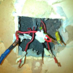

    4 main wires 1 switch (have you seen this before?)
    Thanks all for your help, returned the black floating wire to the other 3 and wired the switch back up and all is working. Another problem i could do with some help if that's ok. I want to change the above light switch (2 gang) to a 3 gang one way. I have under cabinet downlighter to...
    Not joined all the reds together. The blacks in the other switches are twisted together and taped off. In the original pic there is one black wire separate from the other black wires joined together, but i can't recall seeing this separate black wire wired to the switch in an way.
    Hi the below image is of my kitchen light switch. http://www.diynot.com/network/graham31/albums/ I'll try and explain it the best i can. There are 4 main wires coming down to the double light switch. The light switch is a double light switch controling 2 lights separately in my...
