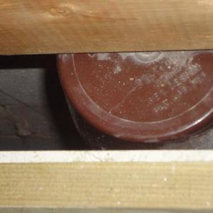

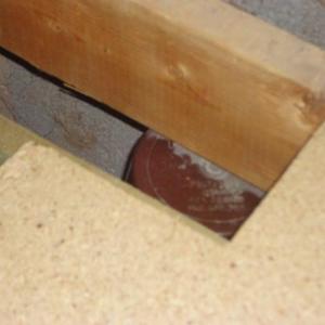

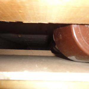

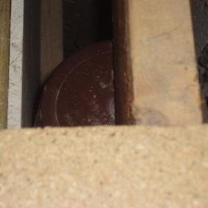

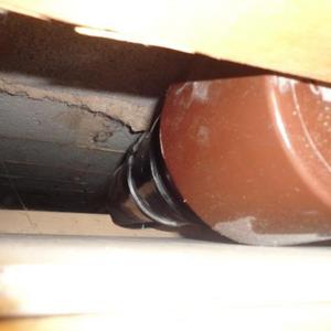

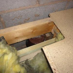

    Restricted access to AAV

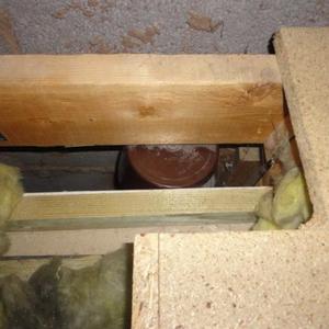

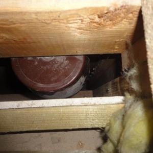

    Evening, I think I have a faulty AAV but I can't get to it to check. It is push fit and moves, bit sits directly below the bottom rail or my roof truss, the top of the AAV hits the roof truss before it comes off and won't move any further. The AAV is also boxed in, and is really close...

    Thanks spraggo, The aav is brand new though, purchased from wickes only a few days ago. I've checked it and it doesn't look like it sticking. Are there different types or air flows? Have I got the wrong type? Have I fitted it incorrectly? It was push fit so went on well and looks fine. The...
