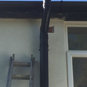

    Extractor siting woes
    Thanks both. I know what you mean about SELV fans but I have found some that go a little higher. For instance the Vent Axia lo Carbon svara goes up to over 100m/hr on boost. Great that there's no problem with soil pipe. So core drill out air brick doable or should I really seal the hole and...
    Thanks for such a quick reply. The air brick is directly over the shower/bath approx 6.5ft / 2m above floor level Pics imbedded. Point taken re brevity. Not my strong point and wanted to be clear.must try harder :-) Bathroom air brick access by Grout Expectations posted 4 Jul 2016 at 12:49...
    Hi all Hoping you might be able to solve a dilemma. I moved into a new house last year. Although the previous owners had had the kitchen and bathroom redone in the previous two months they had not put extractors in either of them. The bathroom seemed like an easy job as there is a plastic...
