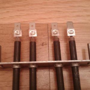

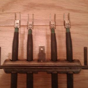

    Zipper, help! I got the spare part and have taken the old grill out but have encountered a problem. The old grill had an extra wire (green) attached to the dead centre push on spade connector, where as the new part doesn't have a home for it. I thought maybe I had bought the wrong...

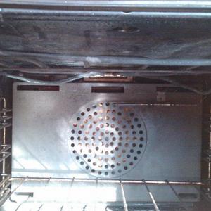

    I've still not worked out what is going on. The oven heats ridiculously slow and now the wife thinks the grill is heating slower too. I had a look at the grill and it does look a bit odd, like it is warped, as you can see from the pic below. I noticed that it also only gets orange hot within the...
