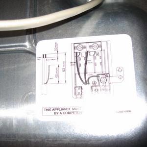

    Hotpoint Cooker HUE61K Terminal Board Connection at rear of
    Thanks for info, just found it strange that you insert a cable, but don't really see how it makes a contact.
  2. H
    Hotpoint Cooker HUE61K Terminal Board connection on rear of
    Thanks flameport. put my mind at rest. So different from the 20 years plus cooker it replaced, which was so much easier, this type of connection just seems to me less robust. Also the old cooker had the connection at head height when sitting behind cooker, this new Hotpoint connection is about...
  3. H
    Posted: Sat Dec 10, 2011 5:00 pm -------------------------------------------------------------------------------- Anybody come across connecting this model or similar cooker, particularly with regard to cable connections onto the cooker. The only instructions from hotpoint are a...
  4. H
    Anybody come across connecting this model or similar cooker, particularly with regard to cable connections onto the cooker. The only instructions from hotpoint are a stuck on label at rear (see photo), with no other instructions. After studying the diagram, where the L/N cables are shown in...
