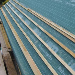

    Insulation
    Yes I have a breathable membrane in place. Stages shown below.

    Constucting new roof
  6. J
    Insulation
    There appear to be two guidelines when insulating between the rafter space on a pitched slate roof. One guideline says to leave a 50mm gap to the top of the rafter the other guideline says fill to the top of the rafter. Which is right?
