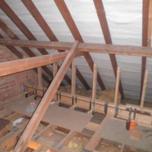

    Removing struts
    Sorry for the delay on the photos, been busy. Will try later. "dont take the struts out til you have beefed up the rafters!" How do I go about beefing up the rafters with the purlin in the way?? Plans state to attach 6"x1" to my existing 4"x2" rafters (BCO said he would be happy...

    Removing struts
    When BC came round last, the purlin wall had not been built. All the Officer saw was the steels in place (bricked in) and the new joists hung / nailed in place. Structurally, according to the plans, the only thing that I have left to do is to beef up the rafters. Unable to do this until the...

    Removing struts
    Apologies in advance if I get the terminology wrong... I just wanted to check that my loft was ready to have its struts and Purlin removed. 1. The steels are in.... 2. New joists hung off steels + on load bearing wall in middle of house. Both Checked and passed by BC. Got told "Good...
