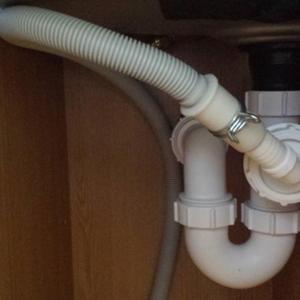

    New Bosch Dishwasher Won't Drain
    Hi Turns out that it was simply a black plastic cap inside the pipe - I pulled it out and we have a working dishwasher. Poor form from Bosch - installation guide didn't show this at all, despite showing every other step! Thanks all for your help!
    Thanks footprints, I will watch out for that - I am sure it's a duff one. rocks1 - thanks for your advice, I have tried removing the black non return flap but I can't see how to do this - do I push it in to the hose? That would surely just push it back into position when the water pressure...
    Thanks you your reply footprints. Yes I was wondering what that was - it looks like the metal clip pushes apart the plastic around the black valve, but that doesn't seem to let water flow. Good point about the adaptor - if I cut it a little shorter that might help. However I have tried...
    Hi I have bought a Bosch SMS40T32UK dishwasher, and have connected it to the cold water inlet, and to the waste pipe under the sink, using an adaptor to connect the 19mm pipe coming our of the Bosch to the 38mm sink pipe. I have ensured that the pipe is raised above the height of the...
