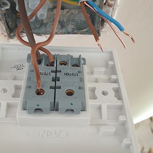

    I followed the post above to get one switch working constantly for the back light. I've seen the diagram above by Sunray but slightly confused by the diagram and how that relates to the wiring I have. I.e which wire is which

    Almost certain to be honest. I took a look for any other wiring and couldn't find anything

    I've tried l1. This works until I use the other kitchen light switch. I then gave l2 a try and it was the same outcome. This is the other light switch the box on the left of the picture is the second control for the kitchen lights. Middle controls another row of lights but is 1 way and...

    Hi, I recently purchased a new build house and they haven't actually wired in the outdoor light!! I have a 2 gang switch, 1 switch is meant to go to the kitchen lights and is 2 way (this is wired in and working). The other should go to the outdoor light. I have wired in the outdoor light...
